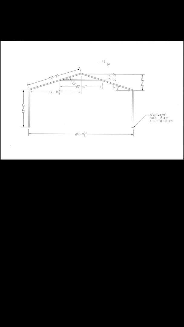

I'm having a helluva time finding out if the 4" square tubing I got last week will work for my shop (columns and trusses. Trusses without webbing or additional bracing that is) All I'm finding is injuneer speak that's WAY over my head. Will it hold up purlins and tin or not? I'm thinking those crappy carports hold up with some flimsey 2" tin can metal, Why wouldn't 4" square work? Only thing that I'm hesitant/worried about is the 40' span. Anyone care to chime in?
#22 ·
What wall thickness are you using for the 4"? What is your truss design? Trusses with 4" Square tubing with no internal bracing will not be suitable for trusses in a 40 span.How far apart are placing the trusses? What is your location so we can see if there to be a snow load issue? How tall will your walls be? What spacing will the columns be? Hand drawings would be OK to see what your plan is.
#25 ·
The metal is 3/16" wall thickness. The trusses and the columns will be one piece (think of your home button icon). Shreveport, La. so no snow load. Max spacing will be 12' to accommodate two roll ups. Walls will be 12 to 14' high. I've come up with a preliminary truss design, I'll tweak it tomorrow and post a sketch of what I have in mind.

#28 ·
Ok, This is what I came up with.
I'm thinking about taking out the cross brace and replacing with 1/2" cable.
